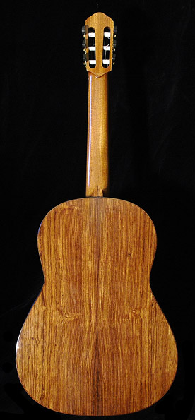

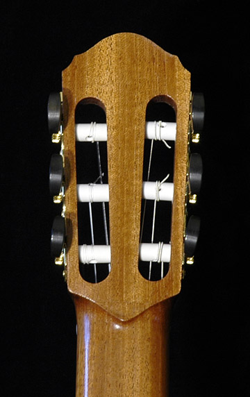

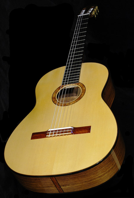

I have no business posting this thread, as I rarely participate in the threads where others post their work. But I really owe Steve at Colonial for saving my butt on this one. When I originally bent the sides they warped horribly on me. My fault, or the wood? Dunno. I knew he had experience with honduran rosewood, so I emailed him asking for advice on how to fix the warps. He immediately responded by saying forget that, I'll just send you some new sides gratis. A few days later they showed up at my door, and a great match to the back besides. So Steve, thanks!

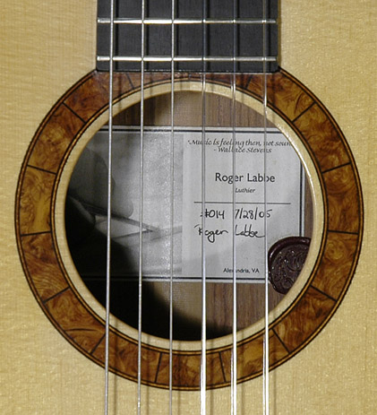

(note: yes, the label is signed a year ago - but I had this on the back burner while I worked on several other guitars. Suffice to say the box went together a year ago)

Roger, thanks for sharing those images, that is one classy looking guitar!

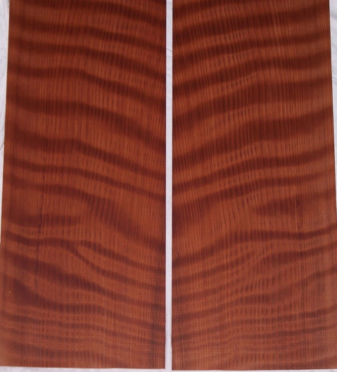

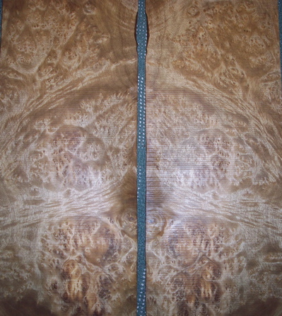

once more steve is the dude,
i just recieved these drop tops from him, burled myrtle and flamed redwood

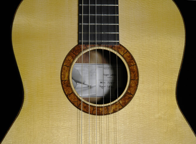

Very nice Roger! What kind of wood is your rosette? I like it a lot.

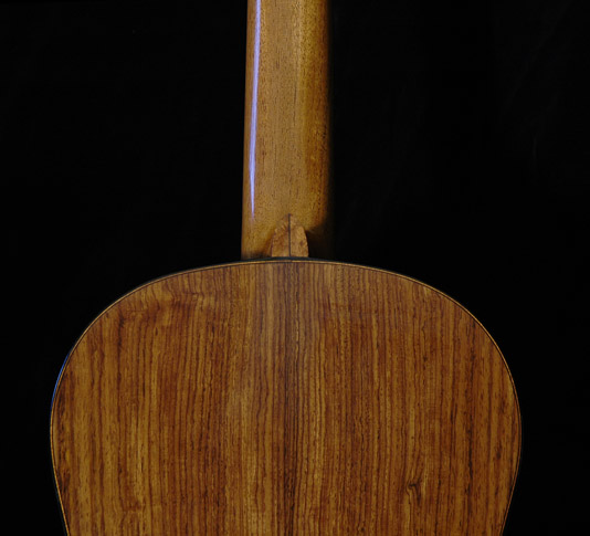

Oh sorry, the woods are Engellman& Honduran Rosewood.
Rosette, tieblock inlay, and enblock inlay are all amboyna burl. It may not be clear from the photos, but all 3 incorporate the brick/tile design. The heelcap is also burl.
Bridge is padauk, neck cedro.
I hate the label, but haven't designed a new one yet.
There seems to be lots of "ping" from the Honduran, but who can say? This guitar probably wouldn't satify somebody looking for the 'bwaaaa' of a super warm (what I call muddy) classical, but it's good if you want to hear every note in the chord.

Very very nice guitar! Ya gotta love Honduran RW...it's wonderful and beautiful stuff.

Thanks Larry, yes I did take them. They are not up to snuff. Too many shadows. I knew they were there, was just too lazy to set up the lights to get rid of them.
For the record, the set up is cheap. It's just a few yards of black velvet I bought at the fabric store while getting some FP covers. Lighting is nothing more than some of those halogen construction lights. A bank of 2 on a tripod, one pointing at the g'tar, one at the ceiling to create bounced light. A third construction light, a clip on I just held in my hand, which is used to eliminate the major shadows. Strictly speaking I should have put that third light on a tripod - I was holding the light in one hand in shooting with the other, so I couldn't get off-axis enough with it.
This was probably $50 in lights and $5-10 in fabric. I need to spend another $5-10 to buy a white sheet of foam insulation. That will be used to get pure reflections in the guitar. In the full sized photos you can see 'stuff' in the reflections.
The guitar is on a black guitar stand, which I photoshopped out of existance.

A beautiful guitar Roger, and I love the smooth taper of the bridge away from the saddle slot- very nice!

Beautiful guitar! I'm sure liking that resette alot

Nice design and workmanship! I really like the shimmer on the top, too.
